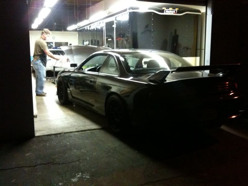

    When it came time to install I was anticipating the hood to be off a bit. But to my surprise the thing just bolted right up and aligned similar to my OEM hood (keep in mind my fenders have problems of their own aligning to the car ). I felt that this is where my purchase with Mike at Kognition paid off. After aligning the hood we installed Aerocatch hood pins without much effort. The whole install took about 3-4 hours with occasional tours around his facility.

    Mike installing the hood while I zone out.
