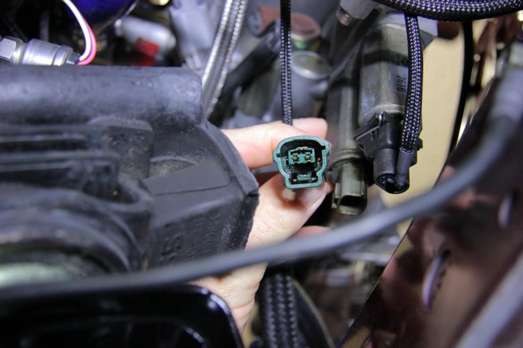

      Originally posted by BEXE View Post
      I'd appreciate it. I feel like its gonna be a pain to source them.
      Here you go Dave...
      If you need anything else let me know, I'll see what I can do.
      VVL S14 on KW's...
      • #18
        Thanks brother! Off to pull-a-part I go!
