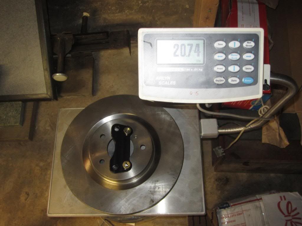

    - Scale with Brembo 350Z track rotors + V2 Brackets (20.74 - 20.36 = 0.38lbs item weight) : +0.38lbs; Total 20.74lbs

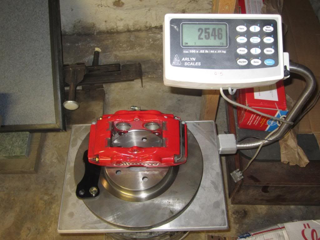

    - Scale with Brembo 350Z track rotors + V2 Brackets + Wilwood Superlite 4 piston/1.38" (0.81" version, which is only a few ounces lighter than 1.25" version) (25.46 - 20.74 = 4.72lbs item weight) : +4.72lbs; Total 25.46lbs

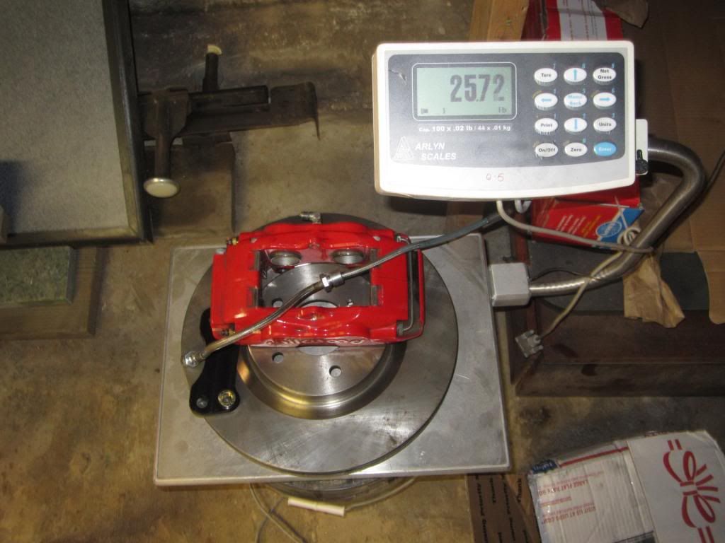

    - Scale with Brembo 350Z track rotors + V2 Brackets + Wilwood Superlite 4 piston/1.38" (0.81" version, which is only a few ounces lighter than 1.25" version) + SS brakeline (25.72 - 25.46 = 0.26lbs item weight) : +0.26lbs; Total 25.72lbs

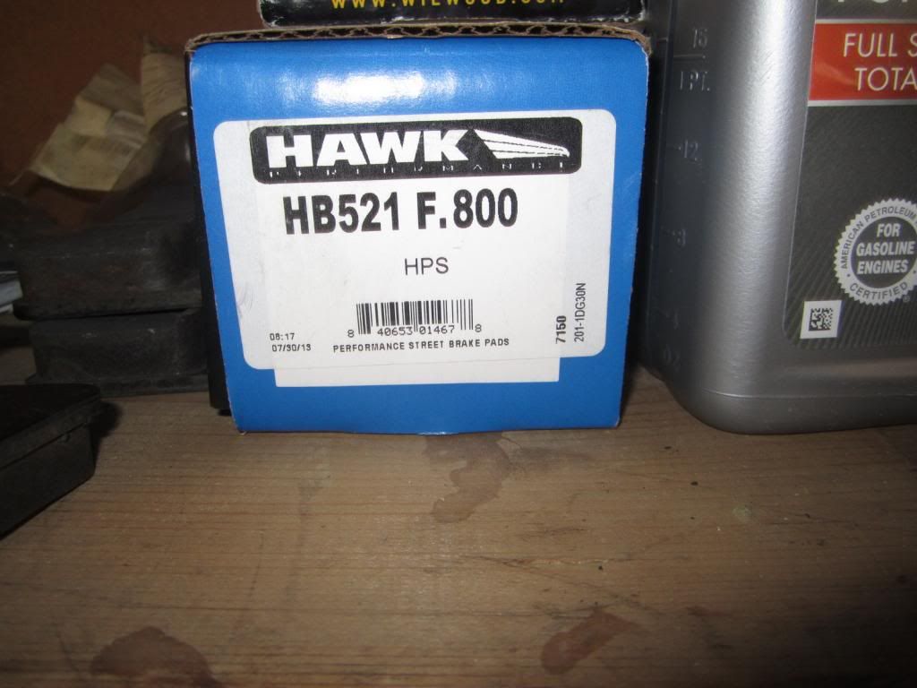

    - Scale with Brembo 350Z track rotors + V2 Brackets + Wilwood Superlite 4 piston/1.38" (0.81" version, which is only a few ounces lighter than 1.25" version) + SS brakeline + Hawk HPS pads (27.82 - 25.72 = 2.1lbs item weight) : +2.1lbs; Total 27.82lbs

    So all in all, only about a 2-3lb jump over stock (25.46lbs vs 22lbs) and only a 1 - 2lb jump over 300ZX all aluminum setup (25.46lbs vs 24lbs)
