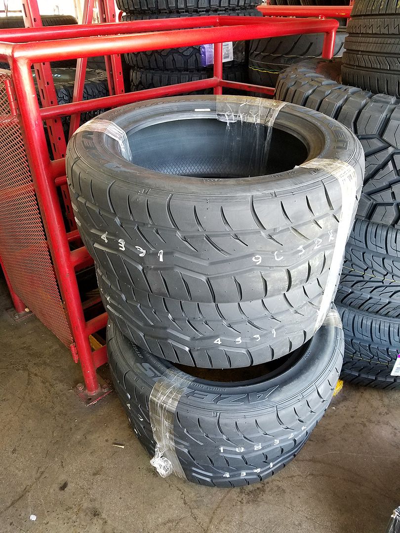

            After everything was installed, I decided to order new tires for the wheels, and ended up grabbing a set of the new Falken RT615K+ tires.
