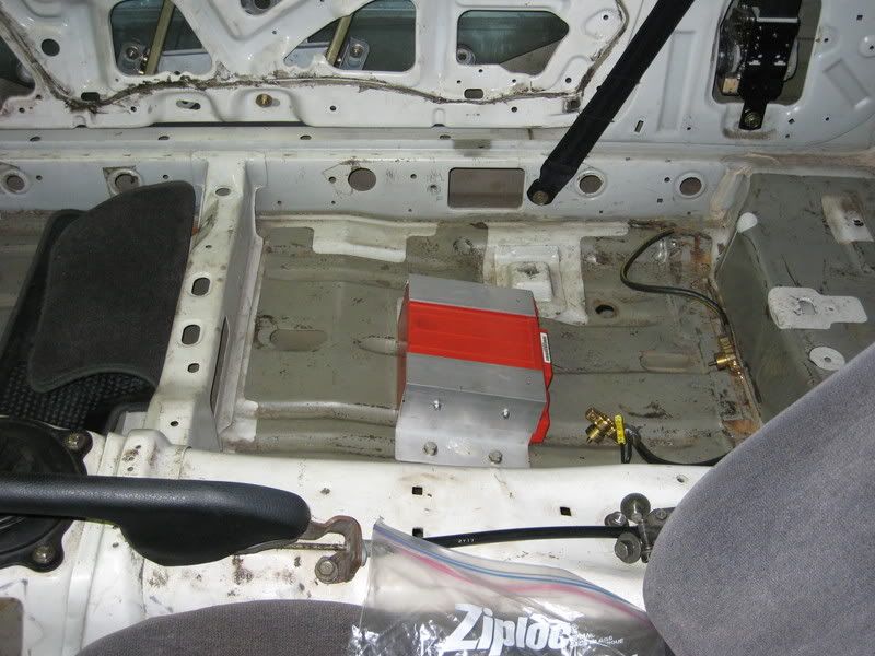

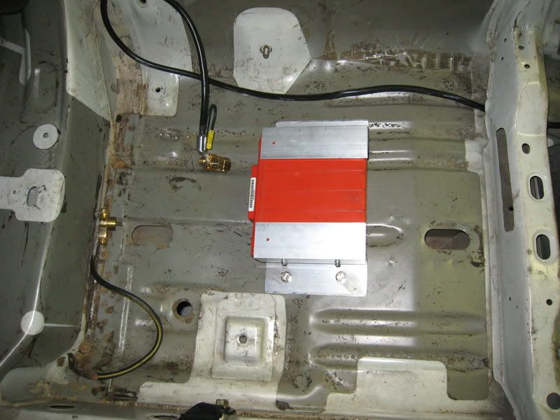

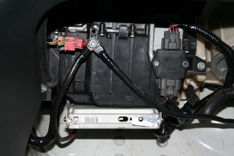

                  I just went back through some of my old posts on another forum... I was using 4 gauge wire, not 8.
                    Here are a couple of pictures of the current mounting:
                    And the old mounting:
                    And my power routing:
                    The wire is 4-gauge from AutoZone. I plan on putting a breaker in over the winter and maybe a kill switch, as I will have everything out of the car to *finally* paint the interior.

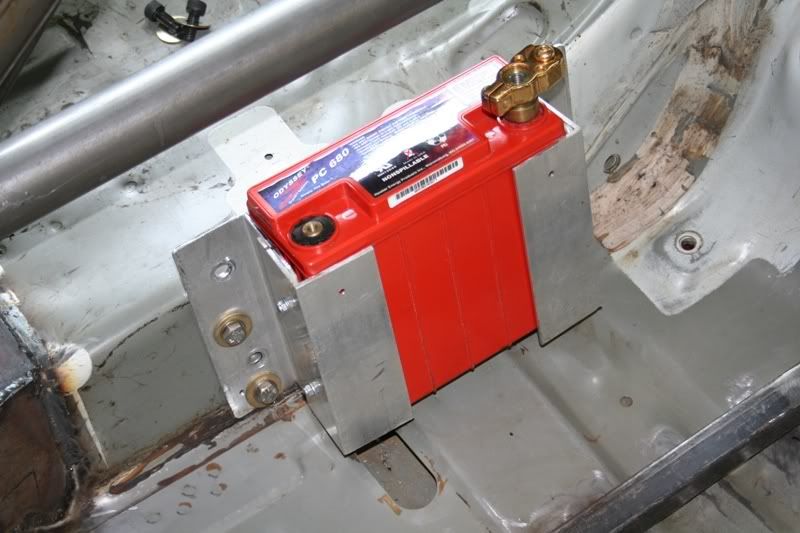

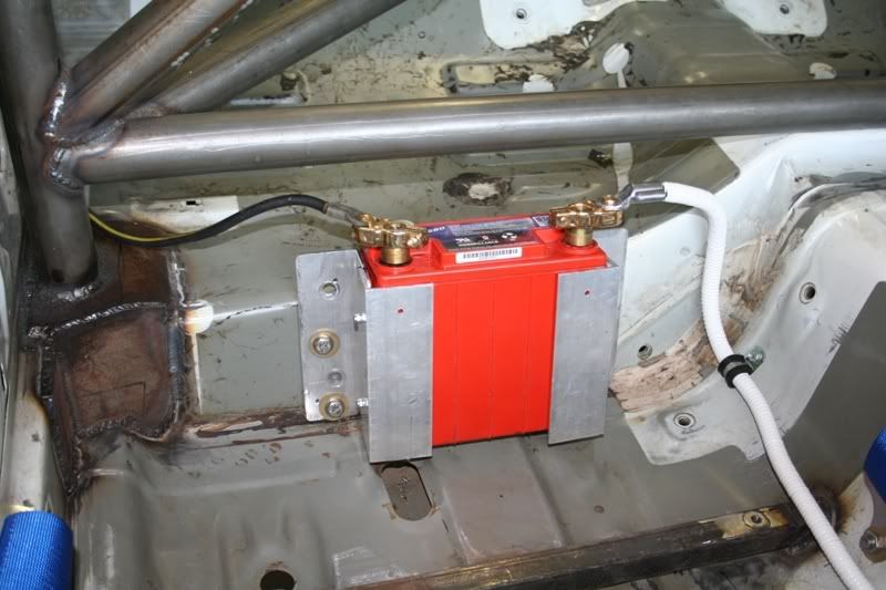

                          I would use at least a 2ga wire for the ground wire, as for the power wire I run a 2ga. I would think 4ga would be a little too small, but it all depends on the quality and construction of the wire I guess. I am going to re-do my power wires very soon so I will have to look into using a smaller guage wire. As for the mounting I use the passenger's rear seat. The only other place I would consider is the pass rear floor, if I had a smaller battery. Anywhere behind the pass rear seat is simply too high in the chasis.
