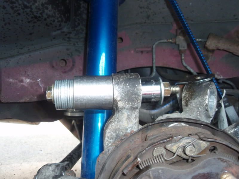

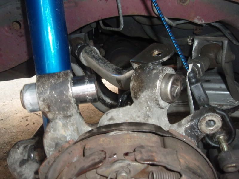

    I needed to get the old bushings out, and press the new bushings in. I'm lazy, and my spindles were already bolted up to the car, so I had to figure out a way to get everything off without too much fire or a press. The result was a couple sockets and a large bolt.
    Screwing around at work:
    "Mini-press" in action:
    Use a bunch of lube between washers to prevent things from heating up too much. Lube on the threads also helps a ton. It all makes torqing everything much easier.
    7/8" or 22mm socket in slip fit into the upright:
    Pressing the new RSSBs in was just a matter of reversing the socket order.
