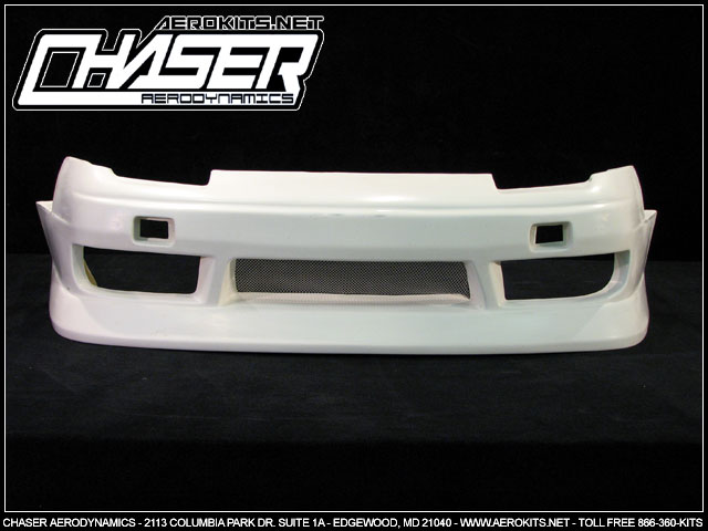

    Something like this would be easier to cut because it has a crease that would make a good cut line. Actually, if you cut it an inch below the crease it might look better and give a solid surface for tape.

    You're right it is really ugly.
    But if you saw my pignose bumper you'd puke.
    At least this one is mostly in one piece and not nearly so destroyed.

    That is a crappy pic, but I don't see a good place to split that bumper without it looking like **** on the road. And just my opinion here, but that thing is ugly to start with.

    Cut it in two, attach metal bracketry to the lower half and make mounting points to bolt it to the car rather than trying to make it attach to the other half of the bumper.

    What bumper are we talking about here? It might be easier to find a good cut line and just attach the lower section to the splitter and when on track, just cover the seam with tape to keep the air flow going the right way.

    Hi,
    I have an aftermarket front bumper I'd like to install - along with a NASCAR front splitter.
    (crappy pic of bumper)
    Just remembering how the pignose lip used to hit and scrape everything makes me not want to even think of putting this thing on.
    However, if I could somehow section this bumper and cut of the lower 4-6" of it, along with making it easily re-attachable (dzus?) then I could still street drive.
    An once at the track, I could bolt on the lower section complete with splitter attached.
    Has anyone done this or seen it done?
