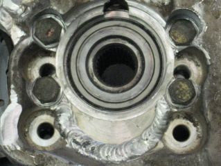

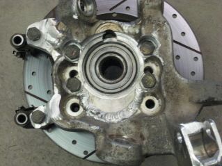

    Not sure if that is the right title but thought this might be interesting to some of you guys. It isn't really roll center correction but it allows you to get your car lower while maintaining stock roll center sooo. I raised it 1.125".

    That is some serious stuff right there. Made your own drop spindles?

      O_O, that must have taken a lot of work.
        That's exactly what PBM did for rear knuckles except they made there's out of Cut metal plates instead of Modding the stock knuckle like yours. Though PBM only did 1"/25mm.
        Looks good. How long did it take for that?

                One of the stock caliper mounts can be kept which helps with the caliper tremendously. My guy didn't understand that and cut them off. Oh well. I checked my notes and I ended up 1.125" higher than stock. I thought it was a good idea and it worked well but the machining was way more expensive than quoted.
                  That's usually how machine shops like to operate isn't it?

                          I wonder if I did this I f it would create more room for a brake caliper at a reasonable diameter....DEF figure that out
                            I'm thinking no. If anything it'd give you more space if you dropped it down 1" and could get some of the caliper below the upright(maybe we can market it as super camber gain kit??? ). It's way too tight up top since the traction arm is sticking way out there.
