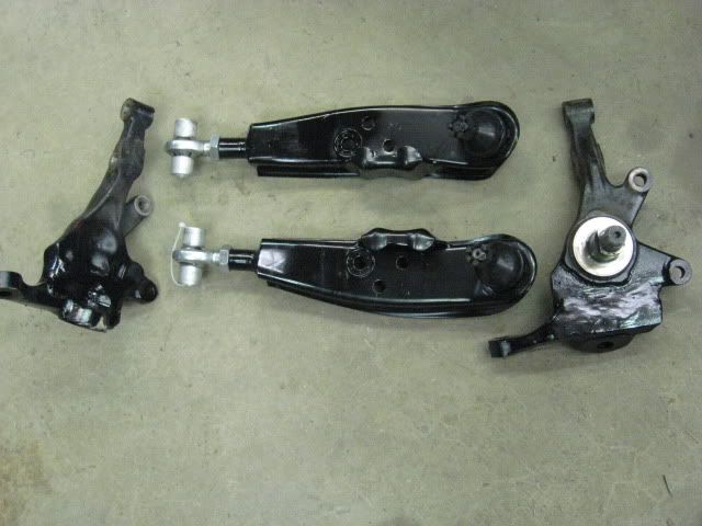

                Is that just DOM tubing welded to the arm and tapped out for the rod end to thread into? To put RC adjustment and heims on the bj side I'm assuming I could go with the the same bolt type setup thats on the modded gs arms? Or would there not be enough clearance between the rotor and lca?
                  It is tubing from Coleman tapped to 3/4 opposite threads per end.
                  Guess you could on the other or modify the spindle as in the above pic to get the roll center correction. There is 1.25" correction on the above spindles with steering changed to 2.25 turns lock to lock on a stock rack and stock bj.
