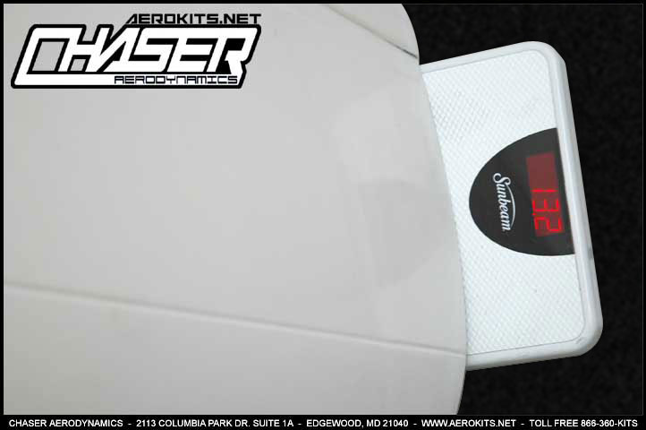

    Fiberglass doors (GTP) $640: -104lbs.
    13 pounds each without glass, stock S13 doors weigh ~65 each without glass.
    $6.25 per pound reduced.

    FRP door weight. Site: http://www.aerokits.net/cart/index.p...oducts_id=4042
    Picture w/scale: http://www.aerokits.net/cart/images/nissan/d753_18.jpg
