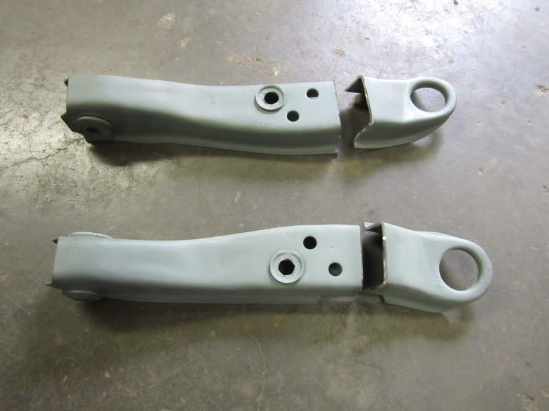

                        The easy solution is spacers.
                        The harder solution is fabrication.
                        You can cut the LCA's and extend them like so:
                        This will increase your negative camber, but you can just take it out with your camber plates, and can probably then rotate them and use them to adjust caster.
