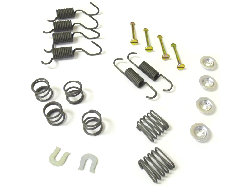

      While we're on the subject of z32 rears...does anyone know where I can get a new set of rear e-brake hardware for the z32 e-brake? I do new/rebuilt everything on my car, and Nissan doesn't sell the hardware kit anymore. I can get the backing plates, but not the hardware.
