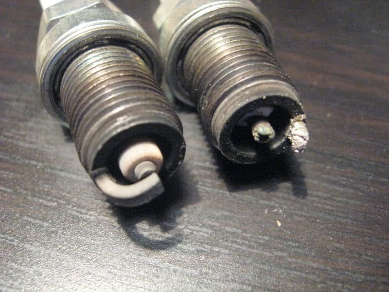

    I filled up my gaz at a different station this time. Same octane rating. I have been running my setup for 1 year on the track.
    This really pisses me off. I hope the ceramic made its way to the exaust without damaging anything.
    Any inputs?
    Setup BCPR6E's -> they will be replaced with BKR7E's They look the same. I just know the 7's are a colder rating.

      Definitely need 7 heat range plugs on that setup. How do the piston tops look?

              Well, you might see nothing on the top of that pistons, or you might see heavy detonation damage(lots of little pits, mostly in the quench area of the pistons). This will give you an idea of what's up with your setup.
              Your plugs don't look too lean from what I can see, maybe running a bit hot due to the 6 heat range, but usually in a lean condition there is much more white on the electrode, and it sometimes looks almost "chalky" from basically cooked off carbon.

                    Can you get a REALLY close up shot of the end of the plugs?

                      Plug chop! (Moped tunning lol) From the looks of it, there isn't much carbon deposit(brown, grey) so I would believe its actually running too hot.

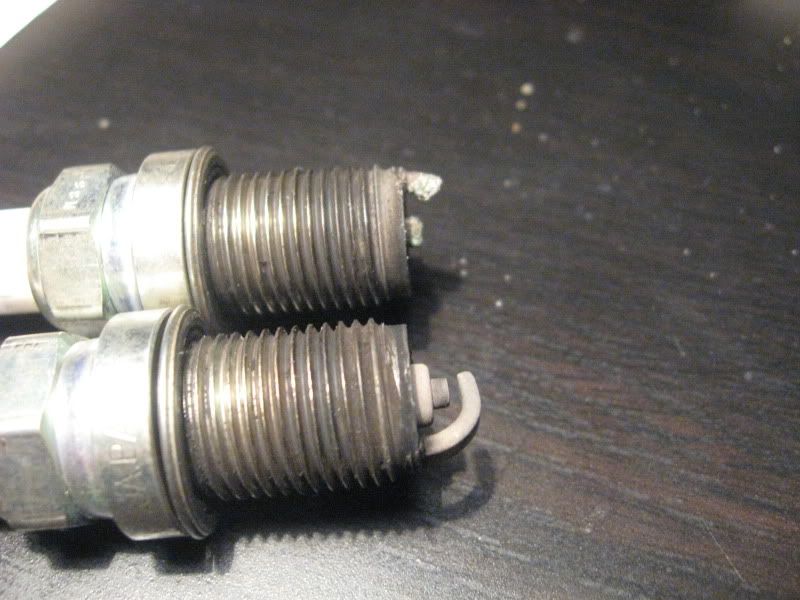

                      I really suck at taking pictures... Thats the best I can do with the macro mode of my camera.

                        The intact plug is too hot. notice how many threads are discolored? that means there's a TON of heat in there and the end of the plug is fawking hot.
                        The dead plug is.. well. dead.. run a plug too hot and it turns into a glow plug instead of a spark plug, which can cause detonation.
                        With luck you didn't grind any of that stuff up the turbo. I'm going to guess the metal was burned away relatively slowly and you didn't send a chunk of steel through the engine, but the ceramic is what worries me hitting turbine wheels and doing damage there.

                        How's the ceramic that's left on the dead plug? does it have "ash" or any spots on it? Is the ceramic bright white, or dull grey/brown?
                        If it's got shiny spots on it, that's the aluminum fromt he engine melting and depositing on the plug. not good.

                          The ceramic on the broken off side is bright white, with some spots of black. On the sides its brownish, more white then brown.
