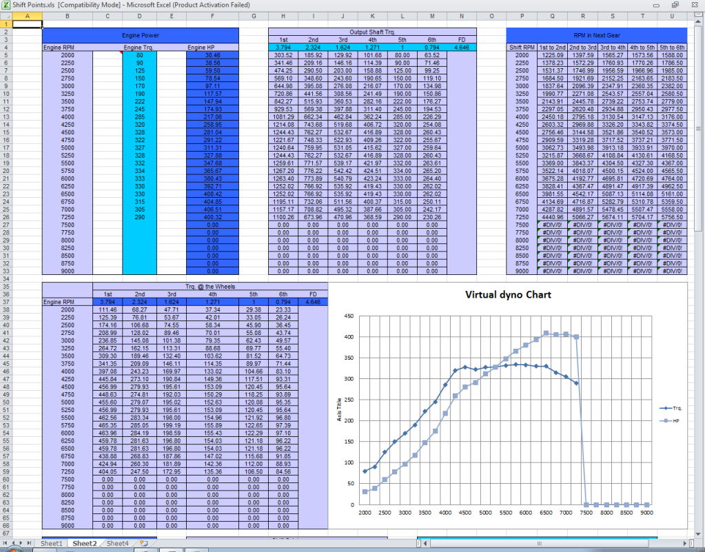

                      So you didn't post a Dyno like I asked but I got bored and set out to find your most recent one...
                      I used this one from the GT2871R thread off Zilvia:
                      Here's some basic info which you may already know, maybe not but here it goes.
                      Set-up 1:
                      *Numbers are assuming:
                      - S13 SR Trans (.759 5th)
                      - 265/35/18 (NT-05 Size you were looking @)
                      - 4.646 FD (Mentioned in here)
                      - Shifting done @ 7250 (Graph only shows up to ~7300rpm)
                      60mph = ~2800rpm
                      RPM Drops:
                      1st-2nd = 4152rpm
                      2nd-3rd = 4985rpm
                      3rd-4th = 5542rpm
                      4th-5th = 5502rpm
                      To my understanding Accel = Trq
                      Avg. Trq. when Accelerating from 40-130 = 163.97ft lbs @ the Wheels (Numbers look small because there figures from the wheel not trq. output from the Flywheel)
                      - RPM Range = 4750 in 2nd to 6000rpm in 5th
                      Set-up 2:
                      - Z32 Trans
                      60mph = ~2800rpm
                      1st-2nd = 4342rpm
                      2nd-3rd = 4903rpm
                      3rd-4th = 5568rpm
                      4th-5th = 5452rpm
                      Avg. Trq. when Accelerating from 40-130 = 164.60ft lbs @ the Wheels (Numbers look small because there figures from the wheel not trq. output from the Flywheel)
                      Set-up 3:
                      - Z33 Trans
                      60mph = ~2925rpm
                      1st-2nd = 4440rpm
                      2nd-3rd = 5066rpm
                      3rd-4th = 5674rpm
                      4th-5th = 5704rpm
                      5th-6th = 5756rpm
                      Avg. Trq. when Accelerating from 40-130 = 171.56ft lbs @ the Wheels (Numbers look small because there figures from the wheel not trq. output from the Flywheel)
                      - RPM Range = 5750 in 2nd to 6750 in 6th
                      If your wondering how I got those numbers what I did was take the Trq. output at the given RPM windows in each gear and divide them by how many RPM windows were added starting from the Closest RPM @ 40mph to the Closest RPM @ 130mph
                      Your trq. is pretty flat from 4250 all the way to 6750 so that's why the numbers/out comes were so close.
                      Screen shot of my Excel: (Nothing fancy, anyone can make it)
                        The Z33 trans will accelerate faster 40-130 mph, but it's also going to add about 30-40 lbs to the car. Pretty much any 3 ratios that will have you topping out right at 130 will net the fastest acceleration there.
