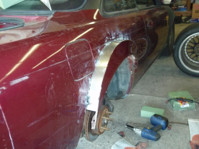

    First step was to cut the fender. I love/ hate this step. It's easy to do, easy to mess up.
    Then I slit the fender well so I could hammer it up and tack it in place:

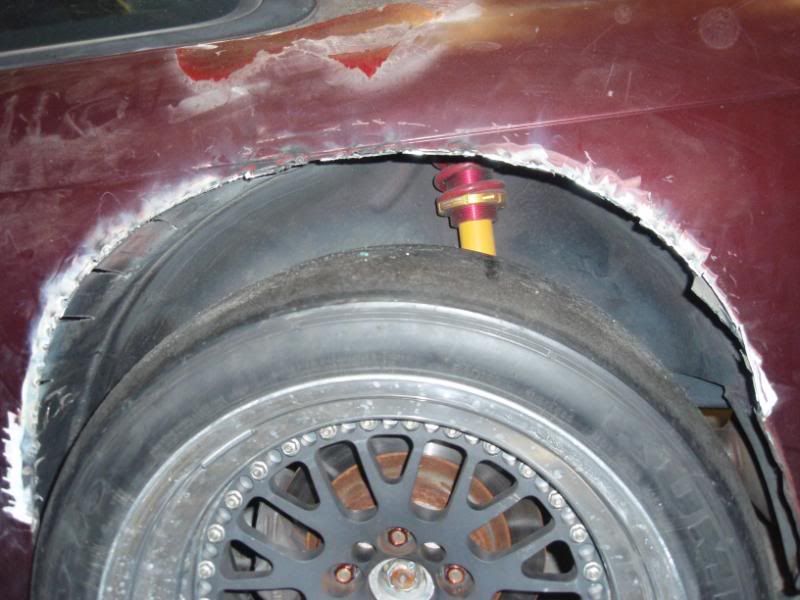

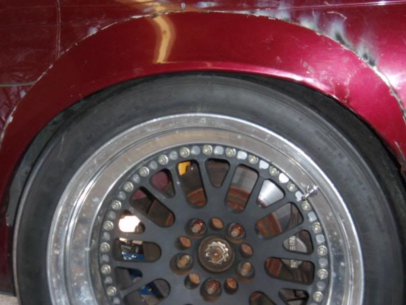

    Test fitting clearance after welding:
    Yeah... it'll fit.

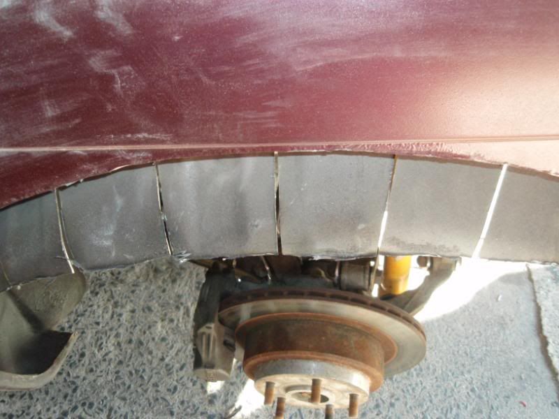

    This time, I decided to keep the stock arch, and space it out horizontally. So, I added some strips of metal to extend the tubs:
    Test fit the tires again:
    I could almost call it a day!! Bondo will fill that in nicely.

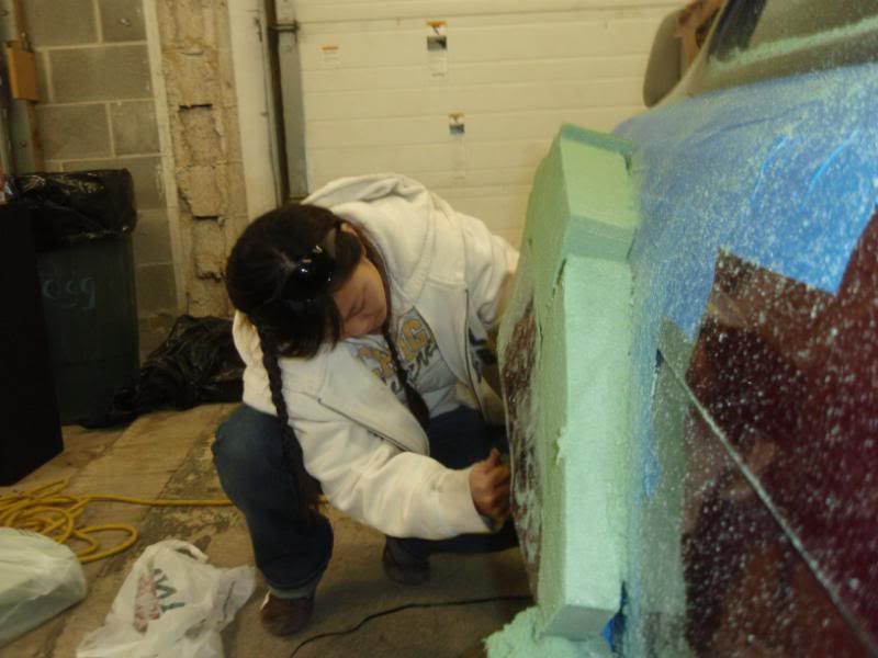

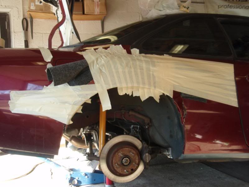

    Tried to figure out how to fill the rest in... since I can't just layer fiberglass over it as is. While I was doing stuff to the oher side, someone started playing with rolls of cloth and tape:
    Looks good!! Let's not do that.

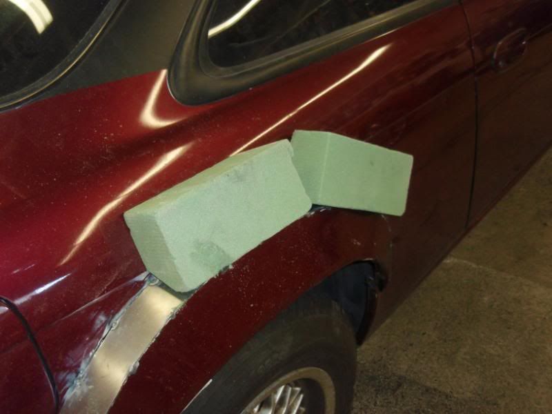

    This requires something a bit more solid:
    That looks little better... add a few more bricks:
    Sweeeeet. That looks awesome. Where's the fiberglass?

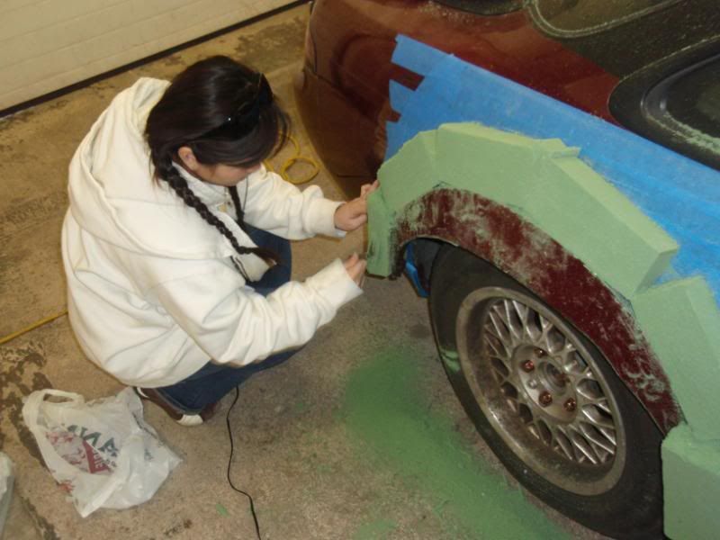

    Of course, Jenna didn't feel the same way I did:
    Crap... it's starting to "look good" and stuff. Where's the fun in that?

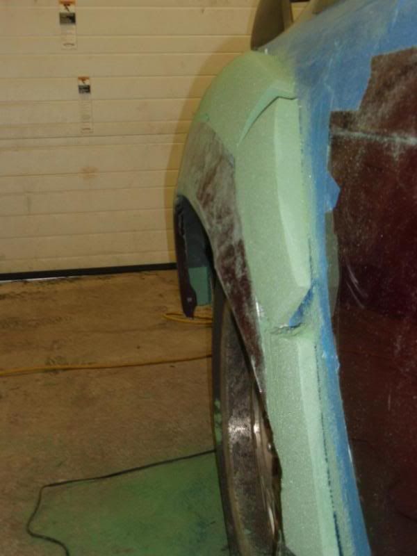

    And some small peices to fill in the gaps...
    Fiberglass to come soon. God bless 315/30/R18's.

            I was tempted to do the "touring car/ JGTC" look, but wasn't sure if I could do it without compromising suspension travel (suspension is "soft" enough to handle roads and such). The other thing I wanted was to keep a stock-ish body look, something like an MKIV Supra or R33-34 GTR.
            Some fleece layered over it shows something of the bodylines:
            If I stretch it a bit it'll hopefully blend some of the contours more and bring the entire fender out.

              Moneyshot:
              Needs smoothing. Looks like a car again.
