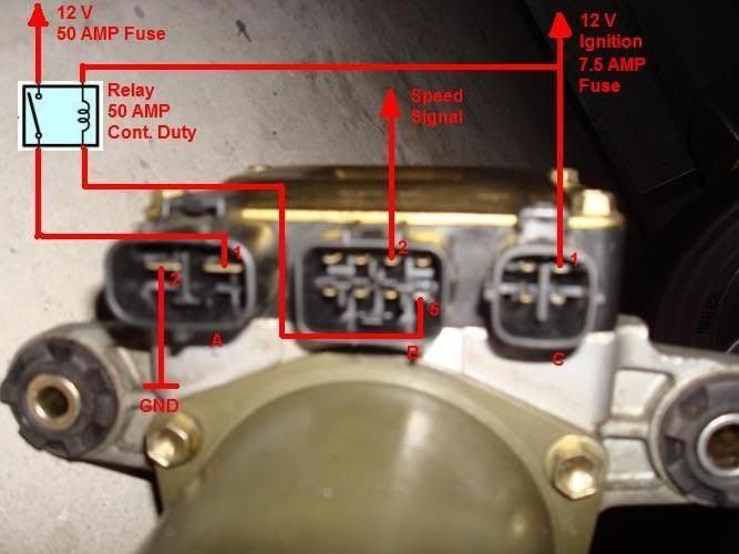

" As a last note, the MR2 Power steering pump has an extra four-wire wiring harness coming out of it. This harness originally connected to a computer on the MR2 which varied the speed (through Pulse Width Modulation) of the pump in relation to the vehicle speed. This makes sense because the pump really never needs to run at full speed while the vehicle is moving since once the tires are rolling, less force is required to steer. At this time I haven't connected these wires to anything, but in the future I plan to make a PWM controller circuit for the pump. "
Many EV conversions have to deal with Power Steering decision. If you decided to keep PS and looking how to drive PS pump, consider this all-in-one solution brought to you by Toyota engineers. Toyota MR2 has EHPS ( Electric Hydraulic Power Steering ) in which pump is driven by its own electric...
There's a lot more info out there on these, but those are the ones I have bookmarked and handy. The setup from the current gen MR2 seems to be the most compact and is the one I planned on using.

Some info I've gathered over the past couple months researching this:
92-95 MR2 EHPS
Draws over 75+A at times
00-05 MR2
Requires only 50A Fuse & Relay
Draws 4A @ Idle
Draws 40A @ Full Load
It does has a VSS Input but I'm not sure on the PPM count for the 00-05 MR2. It can be left un-signaled and is said to wind down slowly on it's own. With the VSS Signal it'll react faster to winding down and such.
Note: VSS Signal is not requires for the Pump to run.
