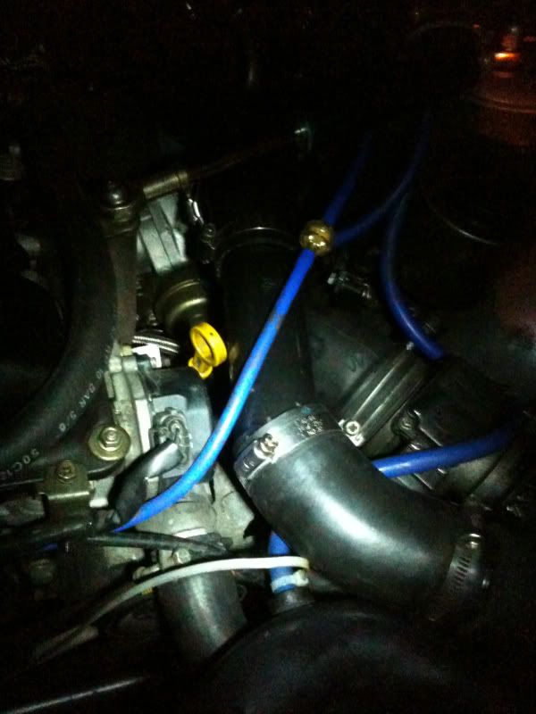

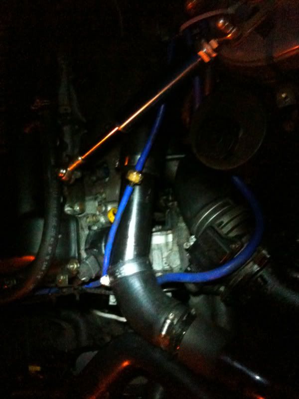

    I forgot my waste gate vacuum...
    Boosted at 20psi....
    You can imagine I am not tuned for that...-_-
    THANK GOD!
    For This
    The save!
    Thats what happens when You just don't stop putting and removing something. I will love at least one track day before winter...-_-.
    Srry for the new thread, I just freaked out ^^ and in need to talk about it. Never heard so much air getting realeased in my engine bay..hahaha. Made a huge blow off noise.
    I'm still not sure what we're looking at...
    Did that intercooler hose pop off of that hard pipe there?

      Yeah it looks as if the hotpipe coupler pushed past the rolled edge of the hard pipe...you can see the lip of the hardpipe exposed in the first picture better. I'd say he was saved by a loose clamp this time.

                    Yup I was saved by loose clamps!!. It actualy sounded like a really ricer blowoff. My heart skipped multiple beats... After all that work, and failing, and failing.
                    At least the air outside was still not that warm, so I wouldn't expect much detonation.
                    You guys can expect me to add wastegate vacuum to my list of MUST do when veryfying the turbo mounting.-_-
