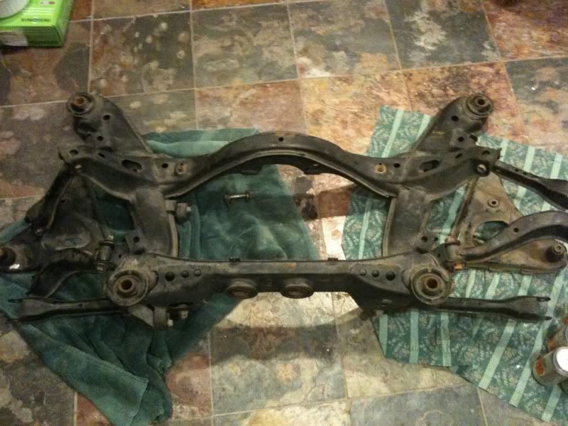

    Ok, are all s14 rear subframes the same?
    Or do I have some other rear subframe?
    I bought the spl aluminum subframe offset bushings, and the aluminum diff bushings also.
    I bought this s14 rear subframe but it only came with a few of the arms.
    I found a local guy and pulled and bought the arms I was missing. They all match except got the right rear lca. For some reason, it looks a lot different than the left rear lca.
    So, WTF is wrong? Do s14 rear subframes differ depending upon year or something?
    Or did I buy an r32 subframe or what?

    The last pic is s14 RLCA. The 1st pic (arm with big hole) looks like s13 or z32 arm.
      This.
      S14 has a 5mm wider mounting bracket for the LCA than the S13 IIRC.
      The toe arm bracket on the subframe side is also 10mm wider(40 > 50mm).
      That is an S14 rear subframe btw.
        Thanks guys.
        I have some q45 rear lca's as well.
        Maybe those will work?
