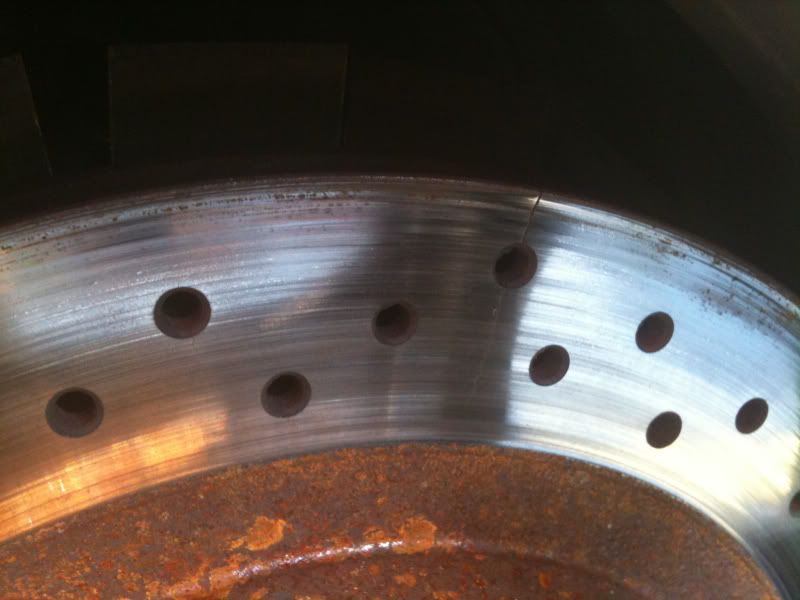

    Disc's brembo plains after this happened.
    They were used discs anyhow.

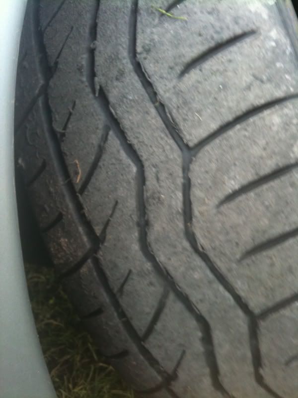

    my tires after two 20 mins runs.. lost 1/8 of compound... I was a little hard on these suckers.
    Rears where chilling, since I don't wheel spin anymore.
