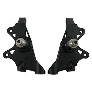

    First up is the Gktech drift/grip knuckle. I like this because GKTech has good customer service and I want quicker steering as it's one of my favorite elements of what I have now.
    At Gktech we now have three different variants of our world-renowned front drop knuckles! All of them are designed and build similar, sharing the following;- Light weight- Robust design- S13/ S14 variations- 4130 Chromoly- CMM measured, CAD designed and FEA tested- E-coated (Electrophoresis Coating)We have tailored the

    I picked up those gktech knuckles a while ago for the s13 and they seem to be quality.
      I've been running S13 Grip knuckles and don't have any complaints. That being said, I literally just bought second hand, new open box S14 drift/grip knuckles to replace my S13 grip versions. Because
      1. I want the quicker steering
      2. S14 hubs come with tone rings still
      I've looked at the FDF knuckles before and wasn't too intrigued by them. That much increased track width is kind of a deal breaker for me. The 350z wheel bearings seem like the best bonus of going that route.

          The FDF knuckles look intriguing... I had the same idea to use 350z front hubs (since I have spares for my G35) with a fabricated knuckle, but I ended up buying the GKTech grip (S14) knuckles and modifying them (more roll center correction and slightly more ackerman due to the corresponding bumpsteer adjustment). They've been pretty solid so far and are a lot better than the modded OE knuckles I had prior.
            Thanks PJ, appreciate your input.
            I think I'll just pull the trigger on those.
