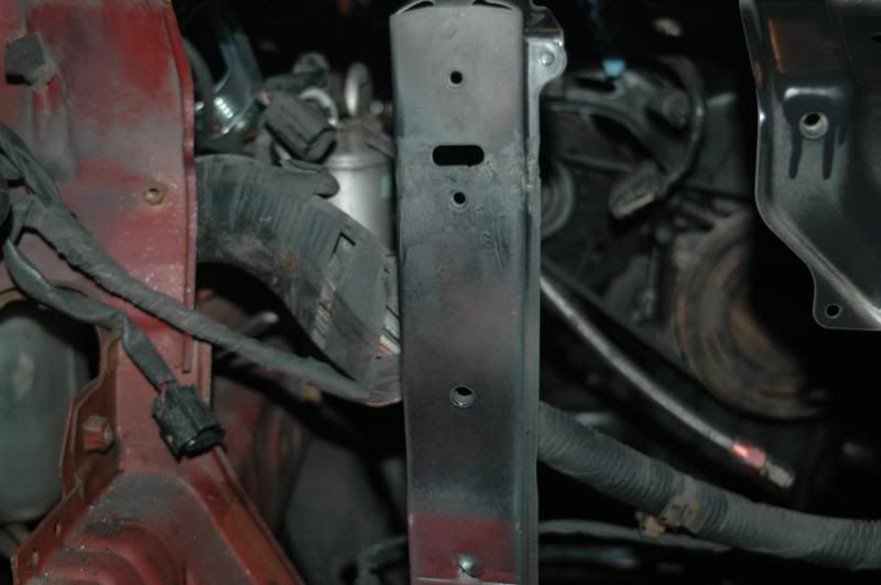

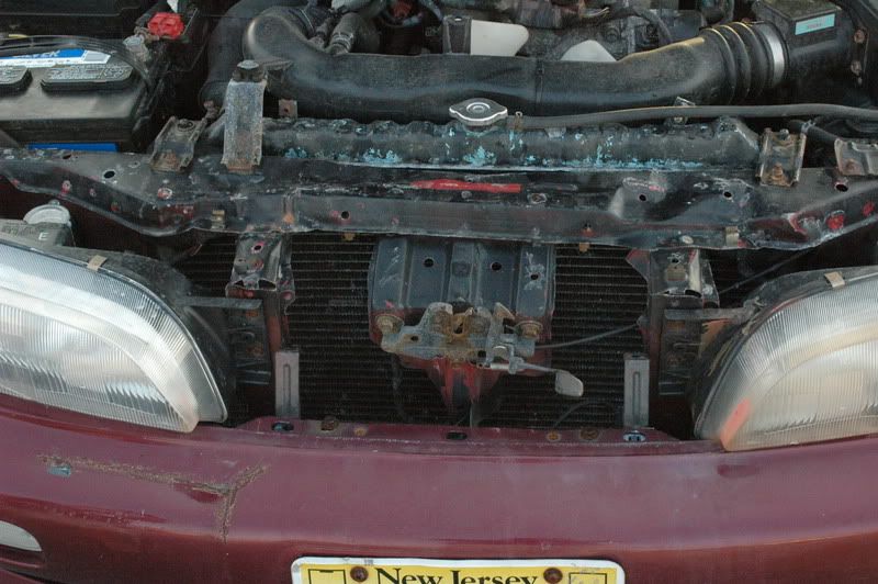

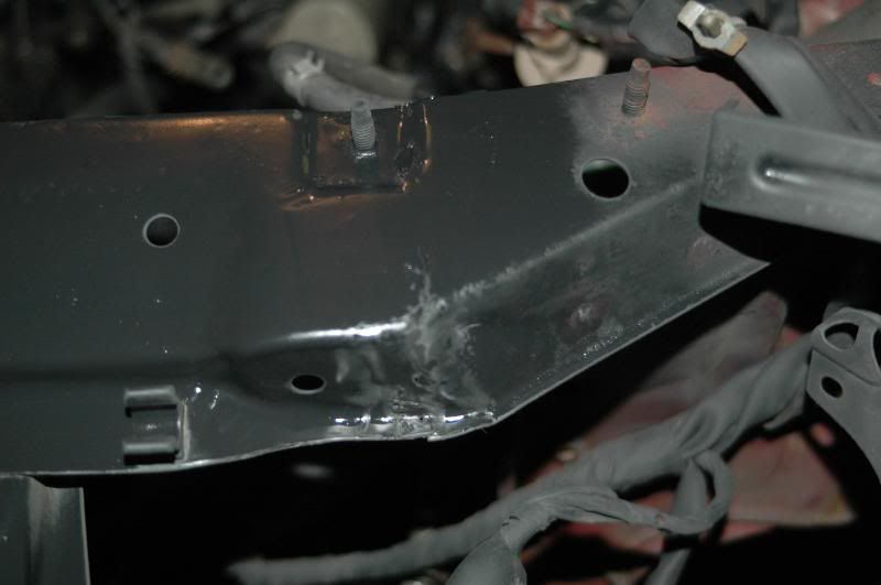

    If you look closely, you'll notice how horribly deformed the radiator core support is. That would be because the car was backed into or rear ended a truck. Either way, it's not pretty. You can really tell how bad it is in the following pics:

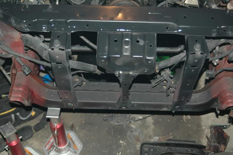

    The core support for the Panda was marginally better, so while I had everything apart, I figured I'd splice the good in for the bad. The bad part is that the headlight and hood latch brackets were cut on the Panda to fit the radiator in per SCCA SM rules (can't cut more than 1lb off, so no bumper support notching). It ended up being a bit more work than necessary, but the end result is much better than when I bought the car:
    You can still tell where I spliced it in. I'll probably grind it down a bit more, but at the moment, I just need to get the car started.

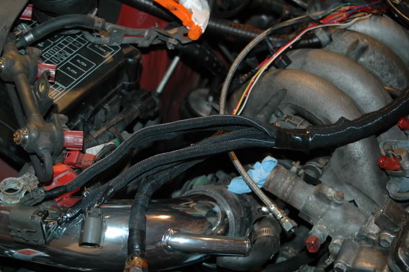

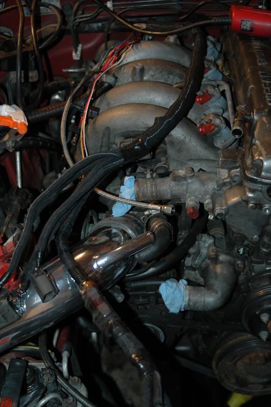

    On the inside, I finally finished wiring in the E-Manage Ultimate. McMaster sells some nice woven wrap-around wire sleeving. I highly recommend. The downside is anything longer than 3ft. you have to use the meshy braided sleeving (which I think Carl has on his car).

      Finished off a bit more of the engine harness:
      I'm loving this woven loom crap. Definitely going to have to get more of it, although I think I should've run the spiral bundling wrap on the larger part of the harness.

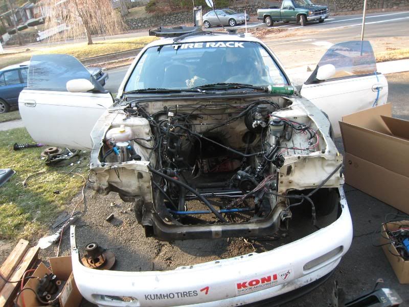

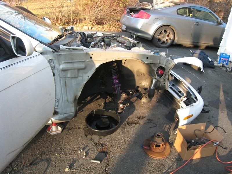

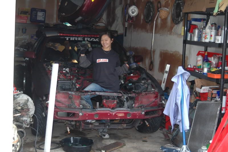

          More hacking, but on the other car. Getting ready to have it picked up by the junkyard
          It still had a full tank of gas since we hadn't made it all that far from home before we were hit last year.
          Just have to cut the roof off to splice into the new car in order to delete the fugly ass aftermarket sunroof. I'm still not sure why I bought the new car other than it was $800.
          Anyways, almost there... just some crazy fab work untill I can reap the benefits of having a racecar.

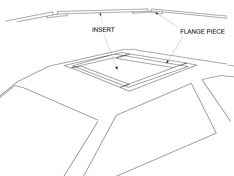

                        Here is a Honda roof re-skin.
                          the edges of the roof are sealed into the window frames and pillars. It'd be cleaner to do the entire roof, but it would take too long for my current time constraints. down the road I might redo it with a new panel.... but I'm betting I'll have a new car by then.
                            Interesting, I wonder if Ryan's diagram applies to the S13. The only guy I know who's done it successfully cut the skin off (not sure how much, but certainly not what Ryan posted), had it welded, etc.
                            My aluminum panel w/rivets and silicone looks like crap compared to the "right way."
