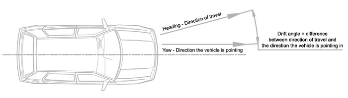

I primarily got the DL1 because due to the "gyro" option to measure slip angle for drifting. The drift angle works OK (calculates based on GPS speed, GPS heading, and yaw rate from accelerometer which is as good as it gets without dual accelerometers and dual GPS offered by the OEM level RTK kit). The issue is I haven't found out how to keep the reading from dropping down to 0 in the middle of long drifts where the yaw has stopped and you're just sitting there at angle.
