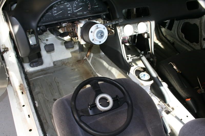

            I really like the Tekniq one. Here is my Photobucket album.
            I like it because it's easy to pull off based on handle design.
