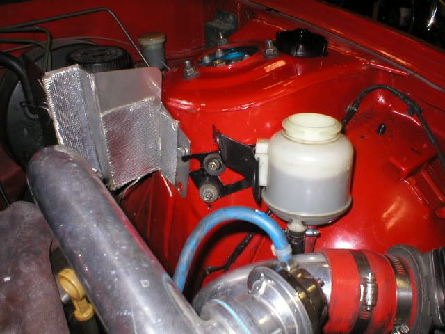

    As I'm sure many of you autox'ers experience losing 1/4th of your power steering fluid out of the cap on the stock S13 PS tank over the course of a day, I thought I would post up my fix.
    I looked at aftermarket tanks, all $80+ for anything decent.....
    Decided one night to inspect closer on my Z roadster..... one large nipple about the size you need for factory S13 hose and one small.........check. Good sealing cap design........check.
    The 5/8" hose was a very tight fit even with some WD but I got it on there.
    Bought a used one on ebay for about $30 shipped including the bracket.
    The Z PS tank design is MUCH better and looks nearly impossible to leak. I took a spirited test drive around the block and got 0 fluid leak where I would have flung PS fluid all over with the stock tank. 2 events this weekend to confirm.
    Pretty sure the G35 tanks are the same, it's also lighter than the stock metal tank.
    Here are a few pics: I don't have a bench vise to bend the Z bracket the way I need so it's not 100% level right now.

              Update: Saturday was what our local corvette club calls "autocross" which is mostly 75-90mph course(10 cones maybe)...... today was a normal autoX type course.... probably 20-25 runs total... no leaks...

                          I think it's more a matter of non-sealing caps rather than boiling fluid. It sloshes around in there pretty good while cornering, and if the cap isn't sealed well, it WILL leak out.
