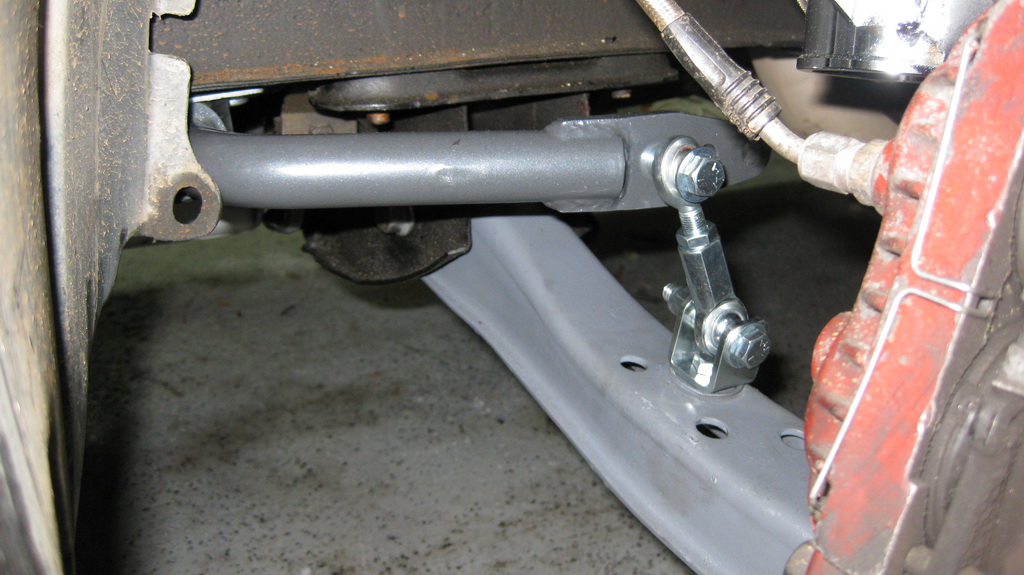

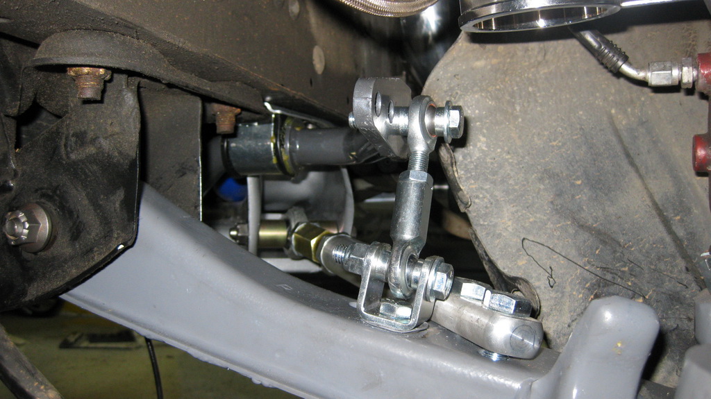

    Any feedback on binding from these pictures?
    Here are 2 pictures of the front endlinks:
    2 pictures of the rear endlinks:

    Secondly how can I test to see there is any binding with my endlinks? I've tried lifting up on side of the suspension, it moves freely. I'm not sure what that proves or doesn't prove.
    Remove the shocks. Use a jack to move the control arm through the entire range of motion that it would normally see. While doing this, watch the endlinks to see if the bearings run out of room to move. They'll hit against the bracket if they are moving too much.

        Jmauld - I tried that, but doing it solo made it hard to do. I'll get someone else to crank the jack while I look at the sway bar endlinks.

            I cranked up the RLCA's. The endlinks on the sway bar straightened up when the suspension was jacked up. So it looks like there is plenty of clearance under load.
            In full droop the heads around the bearings are a bit close to the edge, but everything was working smoothly when I jacked up the rear suspension.
